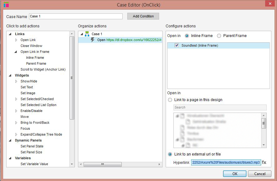

I am building an ipad prototype that needs to play a couple of sound files. So far I managed to add sound files via an inline frame and linking to mp3 in a dropbox. Unfortunately my prototype will later need to be used offline.
In axure 6.5 it was possible to just put the mp3 file into the same folder as the start.html and type filename.mp3 instead of a url.
Now I have axure 7 and my sound files won’t play anymore this way.
This one works:
This one doesn’t:
What did I do wrong? Looking forward to your answers! Thanx in advance!

This one works:
This one doesn’t:

What you’re likely running into is a limitation of mobile Safari, which is that it doesn’t like audio files to be autoplayed. When you load the sound file into an inline frame, mobile Safari is basically seeing that as a file loaded in a new window and it won’t play it until you interact with it somehow. You can use a bit of a Javascript hack in Axure RP, though, to get around this. Instead of loading your audio file in an inline frame, use the action “Open Link in Current Window” and set it to an external URL that looks like this:
javascript:var audio = new Audio(“http://www.audiocheck.net/Audio/audiocheck.net_gangnam16.mp3”); audio.play();
Obviously you’ll change the URL to your audio file, but adding that script to your OnClick event will allow you to directly play sound instead of having it load in an inline frame. This will work on both mobile and desktop, provided your browser supports the Audio element (Can I use… Support tables for HTML5, CSS3, etc).
