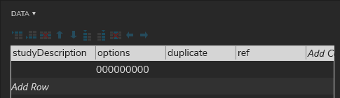

Here is the datasheet for my repeater:
- I kept your “num” and “studyDescription” columns
- I collapsed the 9 “option” columns to one “options” column (with a 9-digit number where each digit represents the state of the corresponding checkbox; and all unchecked by default. To show them all checked by default, change the entry to “111111111”)
- I added a column, “duplicate” to track which rows match other rows
- I added a column, “ref” to track the current “reference row” where say row 1 is tested against all other rows, then row 2 is tested against all other rows, etc.
