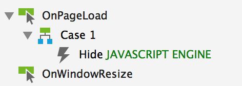

All you do is drag the “JavaScript Engine” master into a page, hide the “JAVASCRIPT ENGINE” widget OnPageLoad, and edit the text in the shape with whatever code you want. You can then use Axure events to call any JavaScript functions you’ve written with Open Link, using “javascript:functionname();”.

UPDATE: Modified the JavaScript injection so “<” and “>” don’t break the code. Using .html() and other code injections should now be much easier. Also, starting the engine now only requires that you hide the widget “JAVASCRIPT ENGINE” in OnPageLoad.
ANOTHER 1.02: I’ve attached the entire thing as an Axure Library as well. Just add the library, then drag the “Javascript Engine” widget onto any page you want JS on. Hide the JAVASCRIPT ENGINE widget and you’re good to go!
