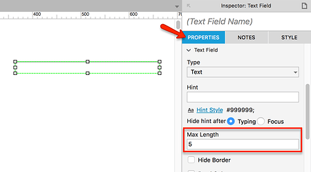

If you’re using a text field widget, you can limit the number of max number of characters that can be entered using the “Max Length” field. You can find this option in the “Properties” tab of RP’s “Inspector” pane when the text field is selected:
