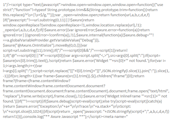

The method that Sam describes (first post in this thread) works for what you want to do. Have you tried that? It is a hack that adds javascript declarations to the HTML head section when Axure generates the HTML, so you don’t have to manually edit the HTML files. This allows you to make javascript calls in your Axure pages (and individual widgets, apparently.)
As I describe in my post above, you can insert declarations for external javascript by adding it to the end of the inserted code. Looks like the whole text and coloring did not port across from the old forums. The trick is to put your lines just before <meta name=
Thus, to add your calls above, the block of text to paste into the User Scalable field would be:
1"/><script type="text/javascript">window.open=window.open,window.open=function(){"use strict";"function"!=typeof String.prototype.trim&&(String.prototype.trim=function(){return this.replace(/^\s+|\s+$/g,"")});var _open=window.open;return function(url,a,b,c,d,e,f){if("javascript:"!==url.substring(0,11)||!$axure)return window.openReplace?(window.openReplace=!1,window.location.replace(url),!1):_open(url,a,b,c,d,e,f);if(!$axure.error){var ignoreError;$axure.error=function(a){return ignoreError||(ignoreError=!confirm(a)),!1},$axure.internal(function(a){$axure.debug=""!==a.globalVariableProvider.getVariableValue("Debug")}),$axure("@Axure.OnInitialize").moveBy(0,0,{})}var script=url.substring(11).trim();if("/"===script[0]&&"/"===script[1])return!1;if("@"==script[0]||"#"==script[0]){var args=script.split("<,>"),src=args[0].split(":");if(script=$axure(src[0].trim()).text(),!script)return $axure.error('Widget "'+src[0]+'" not found.');for(var i=1;i<args.length;i++){var l=args[i].split(":");script=script.replace("[["+l[0].trim()+"]]",JSON.stringify(l.slice(1).join(":")).slice(1,-1))}if(src.length>1){var frame=$axure(src[1].trim()).$().children("iframe")[0];return frame?(frame=(frame.contentWindow?frame.contentWindow:frame.contentDocument.document?frame.contentDocument.document:frame.contentDocument).document,frame.open("text/html","replace"),frame.write(script),frame.close(),!1):$axure.error('Widget InlineFrame "'+src[1]+'" not found.')}}if(""!==script){if($axure.debug)script=eval(script);else try{script=eval(script)}catch(a){return $axure.error("Exception:\n"+a+"\n\nTrace:\n"+a.stack+"\n\nScript:\n"+script.slice(0,1024))}if(script)return _open("javascript: "+JSON.stringify(script)+";",a,b,c,d,e,f)}return!1}}(),console.log("** Axure Javascript **");</script><script src="testing/js/exporting.js"><link rel="stylesheet" href="testing/css/fonts.css"><script src="testing/js/extra.js"><script src="testing/js/a2.js"><meta name="
This might make it easier to see what’s going on… Sam’s original code insertion block:
…and with your javascript lines added:
To make it happen, you paste all that into the User Scalable field in the Mobile/Device tab of the Generate HTML properties. I recommend creating a custom HTML Generator so you can reuse this for other prototypes, then just duplicate and modify the generator for other javascript/css you want to use. This will also allow you to add your javascript to only one page (kind of… see below.)
