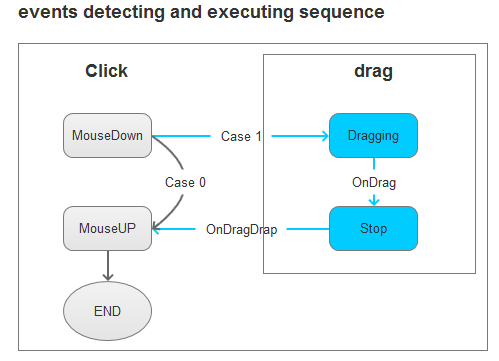

The first method. I replace OnClick with OnMouseUp and add a IsDragging variable to distinguish if it’s dragging or not. If Yes, OnMouseUp is simply to stop dragging. If Not, OnMouseUp=Onclick.
Note that there shall be an interval between the stop of dragging and OnMouseUp as it really happens and a proper waiting time (I set 100ms) is needed to make this work.
The second method is easier, but a little bit ugly. Put another Inspector/Object in the dynamic panel to execute OnClick, while the dynamic panel itself only does the dragging thing.
I think the issue is because Axure always executes Ondrag event prior to OnClick. But actually, OnClick is more essential and should be executed first.
Drag is a special case of Click.
