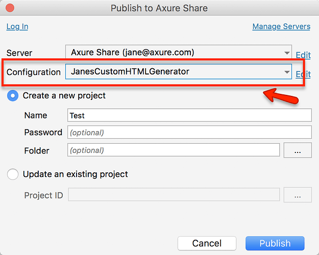

I’m just wondering if there is a way to use these generators to upload directly to AxShare instead of generating HTML files? My team is going through the same situation as described above, where we want to publish different versions onto AxShare for different purposes. E.g., Publishing a baseline version for our developers where we want to show only some of the pages we’ve gotten approved, but we’re also publishing a live version where we’re constantly making updates and the team uses this live version to review drafts. From what I could figure out so far, the generator only creates HTML files but won’t publish them to AxShare. Is there a way to do this? We are using Axure 8 Pro Team Edition.
Yep! What Alyssa explained was for generating directly to Axure Share. So after creating your custom HTML generators, each one tailored for its purpose, navigate to publish your project to Axure Share. In the Publish to Axure Share dialog, select the specific HTML generator you wish to publish the project to from the Configuration dropdown:
This will allow you to publish different versions of your project onto Axure Share. Just make sure to double-check the project ID that you are publishing to when switching the HTML generators.
