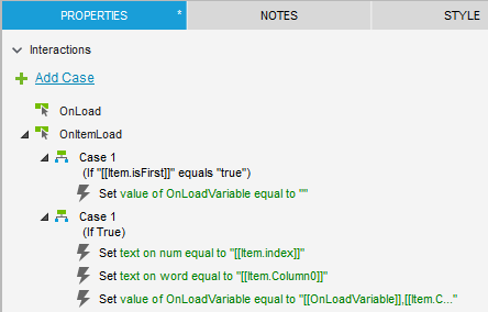

A text field allows entering text. If spacebar or Enter pressed it triggers the “ADD TO LIST” submit button, which adds a row to the repeater with the value of the text field. Here is the code for the repeater:
and because the key part got clipped, here’s the last line:
Because I decided to have the repeater handle the OnLoadVariable string itself, it is critical to reset OnLoadVariable (to blank) for the first row. This method of handling the string in the repeater means that rows can be deleted and the OnLoadVariable string is properly updated. The order of entry is preserved as well.
