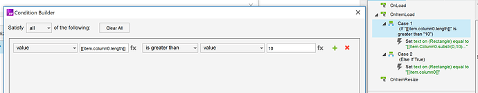

No worries. This should show what’s going on.
The upshot of it:
CASE 1:
If [[item.nameLast.length]] is greater than "10"
    Set text on repeater.nameLast equal to "[[item.nameLast.substr(0,10)]]..."
CASE2:
Else If True
    Set text on repeater.nameLast equal to "[[item.nameLast]]"

The conditional isn’t really necessary here. You could use the first case only without the condition. If the string is less than 10 characters then nothing happens since if the ending index supplied to substr is beyond the length of the string then the whole string is returned.
The conditional is there to add the ellipsis. Otherwise, short last names would appear like “Smith…”
