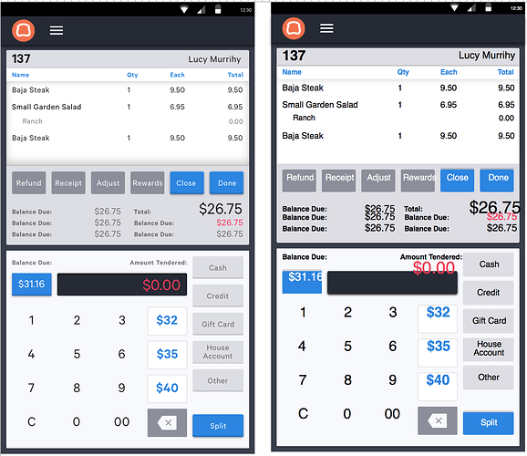

Hi! Yes, selecting all my layers and selecting Copy SVG Code worked great. The problem is that all my text fields are shifted up after being imported into Axure. I had to reposition each of them individually because they were not in the same place as on my Sketch artboard. See my screenshot below. The one on the left is how it looks in Sketch and the one on the right is how it looks in Axure after Copy as SVG Code and pasting into Axure:

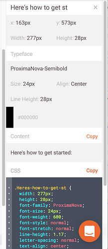

I found another bug in the Convert SVG to Shape. It is not translating the font type correctly.
Here is the Sketch style panel for a given text object:

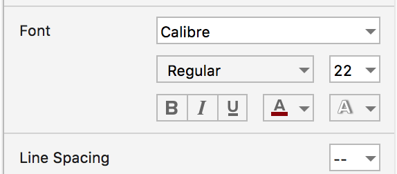

Here is the Axure panel after I’ve copied the SVG code, pasted it into Axure and converted to shapes:
You need to fix the conversion engine so that it actually translates like this in Axure with “Calibre” in the font family field and “Regular” in the font style field. Otherwise, it will not display correctly. Even when I manually fix it, though, the text is still shifted upward about 10 pixels from where it was in Sketch. This seems to be an issue when I use a specially purchased Calibre font, although I suspect there are other fonts that will have similar problems:
Hope that makes sense!

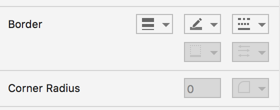

Axure is not recognizing the converted shape properly because Borders and Corner Radius are greyed out:

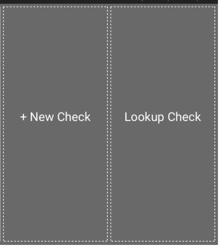

In a related note, notice here how my dotted border in Sketch is incorrectly converted into a solid border in Axure:

For the text-shifting and font conversion issue, this was reported by popweb on this thread, and Alex and I have gotten these two bugs filed with our QA team.

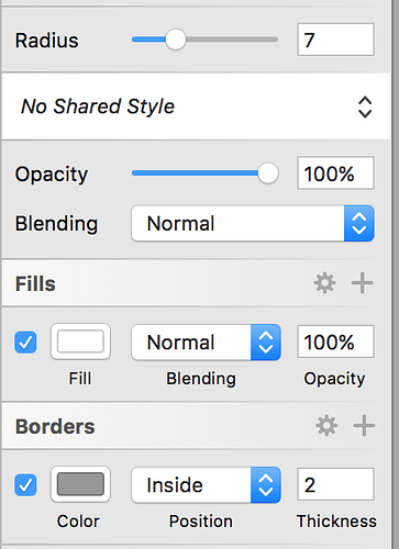

For the border and corner radius issues, I wasn’t able to reproduce either of these. When copying over a Sketch shape with border and corner radius, for example, it pasted into Axure RP with those options enabled. Similarly, copying a Sketch shape with dotted borders pasted into Axure RP with the same dotted lines. If possible, could you take a screenshot of the applied shape settings for both shapes from the Sketch tool? Here’s an example:
Seeing the styles of those two shapes in Sketch–one with border/corner radius and the other with dotted borders–should allow me to reproduce the two issues on my end so I can get those filed with our QA team as well. TY!
Jane,
When I tested these, yes Corner radius wasn’t brought over as an editable attribute into Axure - instead it just created shape control points to simulate the rounded corners (which worked visually for the pasted settings) - however this makes the corner radius no longer editable once it is in Axure, which is less than ideal.

Here is the dotted line I tried to import from Sketch:
Here is the white button with the “9” on it (where corner radius was greyed out):

I was able to reproduce this bug where the SVG loses its dashed border after converting the Sketch SVG into a custom shape in RP 8, and I’ve gotten it filed with our QA team.
As for the issue with the corner radius, I talked to our dev team about this and it turns out this is actually by design. When converting the SVG into a custom shape, that SVG is now a vector shape in RP. You’ll see the same thing when using the Pen tool to create a custom shape or converting a Box widget into a custom shape in Axure RP where its rounded corner attributes will not be available to edit. So while images/rectangles can have rounded corners, custom shapes cannot. Nonetheless, I’ll be happy to pass this along to our product team about the ability to round corners on custom shapes.
