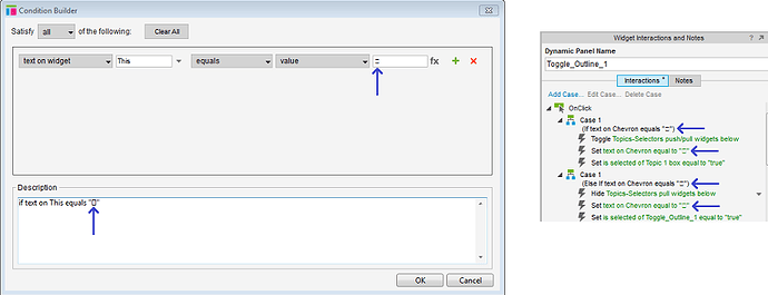

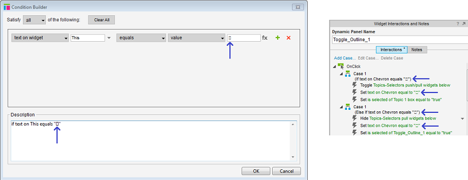

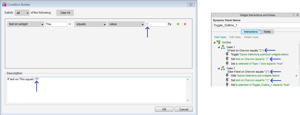

I have successfully gotten Font-Awsome onto my computer’s Font folder as well as into my Axure Library. I have no problem with them rendering or using them in my prototypes, screens etc.
The issue I am having is in the “Widget Interactions” and the “Condition Builder”. Font-Awesome appears as blank squares. This is problematic when i want to perform an interaction based on the “icon”.
For example, if text = “^” then set widget to “true”.
I have seen lots of “blank square” issues, but none that address the font-awesome not appearing in the Condition Builder.
Thanks in advance!
Hi trillaggee,
Thanks for following up on this. Currently I’m afraid rendering the icons in the conditional builder isn’t supported, but we’ve logged similar feature requests lately, and yours definitely hasn’t gone unnoticed. Though interactions seem to be correctly governed by the copied-and-pasted icon in the condition, showing an actual representation of the icon in the condition builder isn’t available at the moment. We’ll look into this!

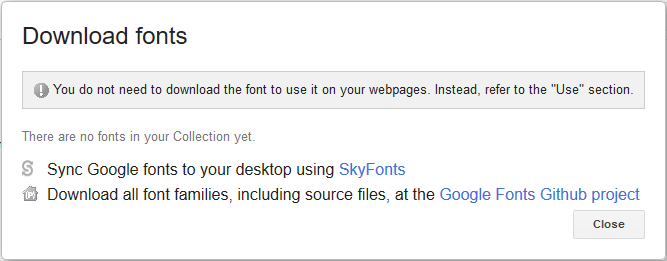

Hi. I’m trying to follow this tutorial, but Google seems to have changed its system, to the point where Step #4 no longer works.

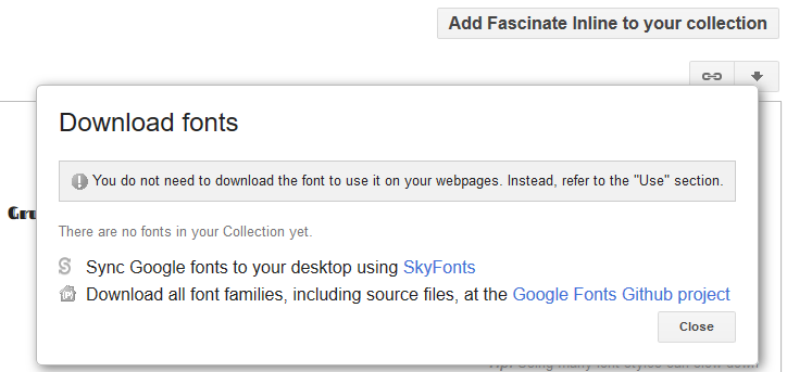

The picture shows me clicking an icon with a downward pointing arrow on the Google site to download a local copy of the font that I can use in Axure. However, there are two problems with that:
  1. Google is urging me not to use the “Google Fonts” URL from Step 1, instead giving me a popup that says “A new version of Google Fonts is available. Take me there.” If I go to the new URL, there is no Download button like the one in step 4.
  2. If I instead stay on the “old” page and click that Download icon, I get this popup message:
In case that image doesn’t display correctly, the text says:
Download fonts
You do not need to download the font to use it on your webpages. Instead, refer to the “Use” section.
There are no fonts in your Collection yet.
Sync Google fonts to your desktop using SkyFonts
Download all font families, including source files, at the Google Fonts Github project
There doesn’t seem to be a section on that page called “Use.”

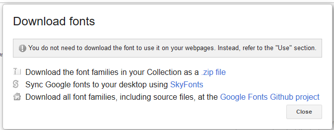

Don’t click the “Quick Use” button at this point, or you won’t be offered a chance to download the zip. You will instead end up getting a popup message that says “You do not need to download the font…” that looks like this:
(Note: That version of the popup does not let you download a zip file.)
  1. Having added the font to your collection, you can click either the Review or Use buttons at the bottom of the screen:
    2016-08-02_1528 - alexkuo’s library
  2. Whichever button you clicked, it will take you to a page where you can find an Arrow button that means Download. It’ll be there, somewhere toward the top right. When you click the arrow, you will still get a popup that says “You do not need to download the font…”
    However, you’ll now see 3 choices rather than 2, the first choice being an option to download the zip file.
