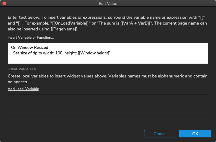

Awesome! I typed in the code and it’s not working, but I think we’re really close…
Did I enter it correctly?
