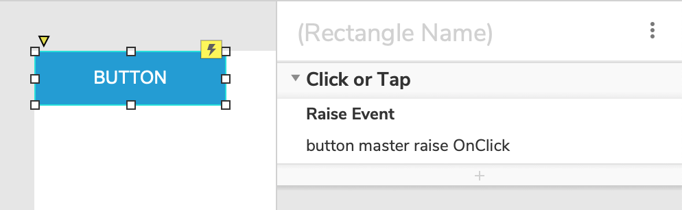

A master is appropriate. What you need to do is “raise an event” by going into the master and creating a Click or Tap interaction on the button in the master that raises an event called, say, OnClick:

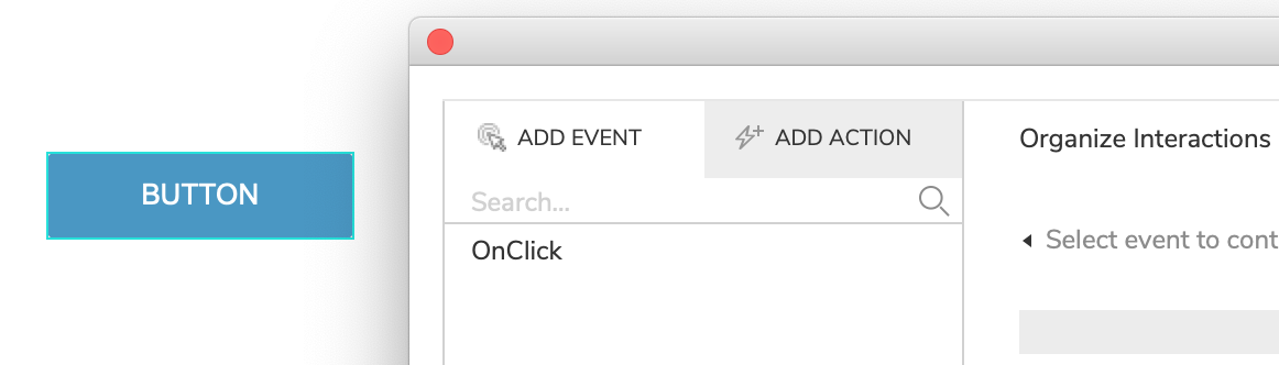

Then, when you are outside of the master and select the master, you’ll see this OnClick event, in which you can place the script that you want to run when the master is clicked:
