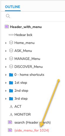

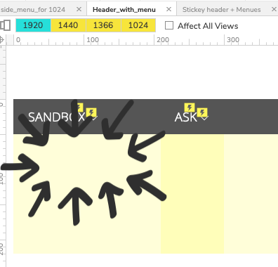

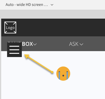

for some reason, a specific master which appears in the most narrow master view, does show in the preview base even though it is properly hidden in the outline panel, and does not appear on the canvas design mode…
Preview:
Outline of that view:
Design mode of that view:
BTW - How can I get read of the large circle in Preview mode which appears only with adaptive views?
