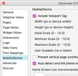

I couldn’t duplicate your issue upon publishing to Axshare: the adaptive views worked. For the mobile view, be sure to turn on the viewport tab in the Generate HTML dialog.
hi
i did what you told me… still, when i export i see in the browser only the mobile view…
