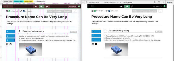

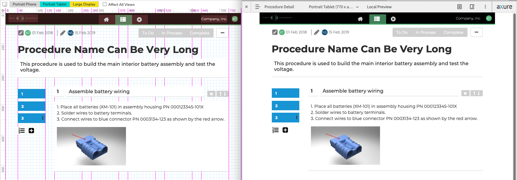

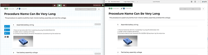

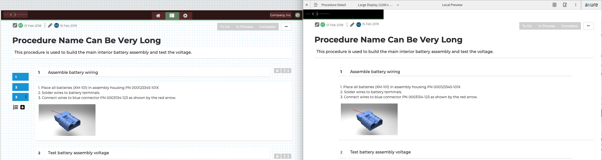

For some reason, my Large Display Adaptive view is only showing the items that have been placed in the Base View, even though the my Tablet - Portrait view in the middle renders fine (screen shot limit, can’t show)
In my adaptive views, each inherits from the previous (sorry, screen shot limit can’t post)

The weird part is how the middle view has no such issues, only the last one. If re-placing doesn’t work, I will try removing the last view and re-adding it.
Between base view and last view, everything is placed fine and no issues rendering. It’s like somehow the base view and last view have become conflated in the back end.
UPDATE: Removing last view and re-adding it did not work. It still treated it as a variant of base view with different dimensions but same placement rendering issues.
