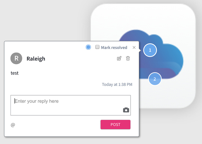

Hello @hulaomr I hope you are having a wonderful day! I came across this thread and wanted to follow up on it.
Today, we have an extension in chrome which you can use to associate a screenshot to a comment. I believe this addresses the issue you are running into.

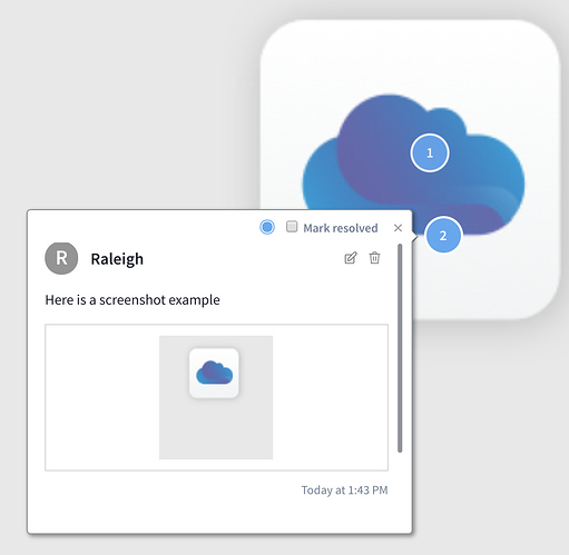

If you open Axure Cloud in Chrome, install the Chrome extension, and then add a comment/reply to a project page you will see a little camera icon in the comment text box (shown in image 1 below). Clicking on this icon will launch a screen capture workflow which you can use this to capture the current state of the dynamic panel that you are viewing and upon completion it will associate the image you capture to the comment. Therefor, when someone views your comment they will also see the image you captured and know what state of the prototype you were looking at while commenting (shown in image 2 below).
1.
2.
Does this address the challenge you are facing or are you looking for something different?
