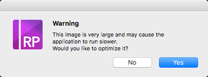

When importing the GIF into your RP file, would you happen to be optimizing it at all? If so, could you try importing the GIF without optimizing it (clicking âNoâ if the option pops up) to see if that helps?
If that still doesnât allow the GIF to play as expected, would you be able to attach both the GIF file and the RP file youâre currently working with? Having those files should allow us to get a closer look at what might be going on. Thanks!
