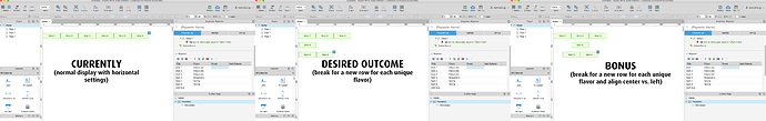

I’ve uploaded an .rp file, along with a screenshot of what I’m looking for:
break_example.rp (46.6 KB)
Hoping someone can edit the .rp file to get the desired effect. Thanks!

Your “DESIRED OUTCOM” is easy to achieve, but “BONUS” can go the other way, besause Axure uses absolute positioning.
Preview: https://tebz39.axshare.com/#g=1&p=home
Does this solve your problem?

If your container is fixed length, it is possible to achieve the centering effect you want.
