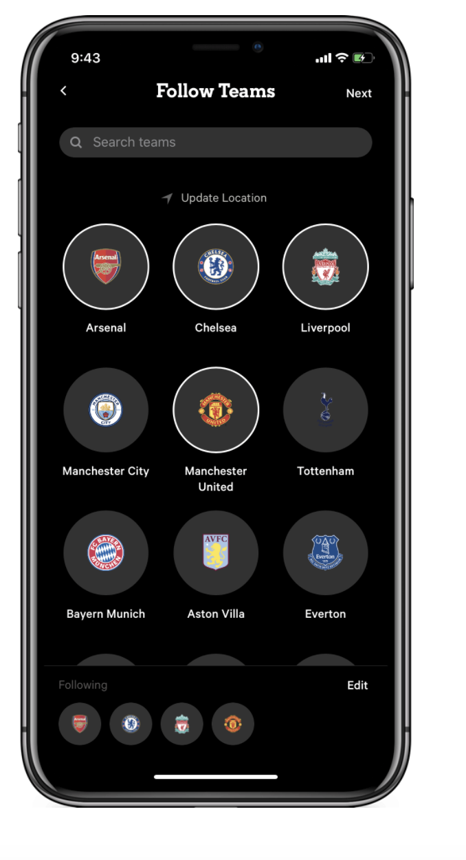

I am trying to prototype a similar interaction to this one:
Where the user can select logos and have them appear in a drawer. I need this to be dynamic, so they appear in the order they select them.

I would arrange this with two repeater lists, one for the main area (grid of big logos) and one for the drawer area. When a logo is selected, it can add a row to the drawer repeater (using its own data), which would automatically add to the end of the list, so in the order it is selected. Style the repeaters as horizontal, with the first repeater set to “Wrap (Grid)” with 3 items per row. To set up the graphics within each repeater, I would recommend a dynamic panel with a state for each item (each team in your example) and simply change the state in the Item Loaded event as needed to set the team. If you aren’t familiar with repeater widgets, I could set up a demo for you to inspect.

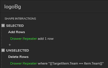

Yes, by “its own data” I mean that each row has data in the dataset–the values in each cell–e.g., a column of “Team” can have row-by-row values of “Chelsea”, “Liverpool”, etc. So, when an item is clicked and selected in the first “teams” repeater, it can add a row to the drawer repeater using [[Item.Team]] to reference “it’s own data.” Likewise, if a selected row is clicked to unselect it, it can delete the associated row. Here is a screenshot from my demo .rp file below:

To make this work with images, the second “drawer” repeater needs to be preloaded with an image for every possible item. My method uses a dynamic panel with a state for each image/team. @josephxbrick uses a method in which each image is pre-loaded in a dataset column (using the “Import Image” option for a dataset cell; right-click a cell to find this feature.) Either works, as you can see. Actually, my first thought was to do something like this but I didn’t want to mess with a way to sort and ensure the order of inclusion. I like his timestamp method, though. Like @josephxbrick, I use the Selected and Unselected events to modify the second repeater, adding a row or deleting a row.
The first repeater is not critical to include, but since they are two versions of the same thing, it was fairly easy to just make it, then duplicate the first “teams” repeater for the “drawer” repeater and resize things. The repeaters are located inside dynamic panels to allow for scrolling. The drawer panel scrolls horizontally (hold down the shift key when scrolling to use on a desktop) in a nested panel–such that the outer panel hides/masks the scrollbar (you can do same for the top teams panel if you like.
