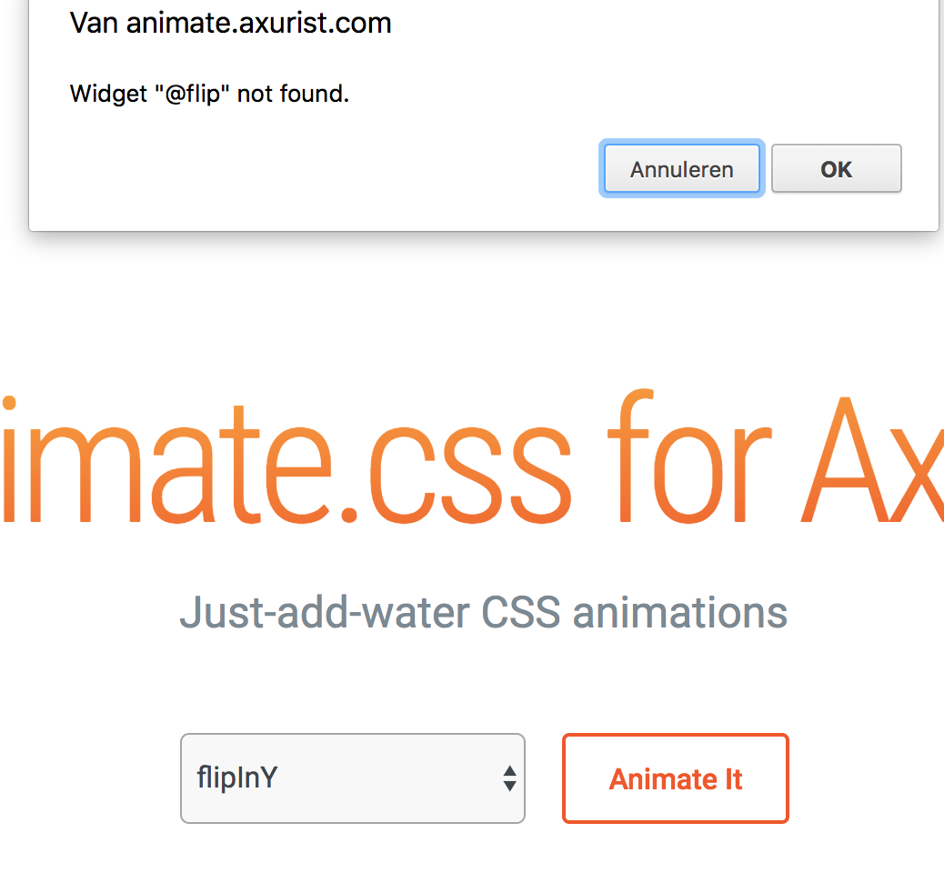

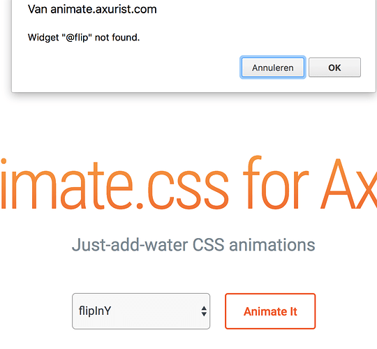

Flip doesn’t seem to work :frowning:
Fixed! You can download a new file: http://animate.axurist.com/animate.axurist.zip
Thank you, buddy! :beers:
