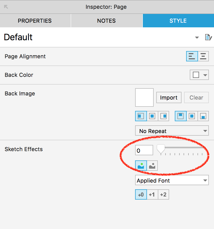

It looks like if I apply any Sketch Effects, or change the color to BW, it will stop the gifs from animating. After I set these settings back to default, the gifs worked again. This might be helpful for others to know too! See attached screenshot showing these default settings.
