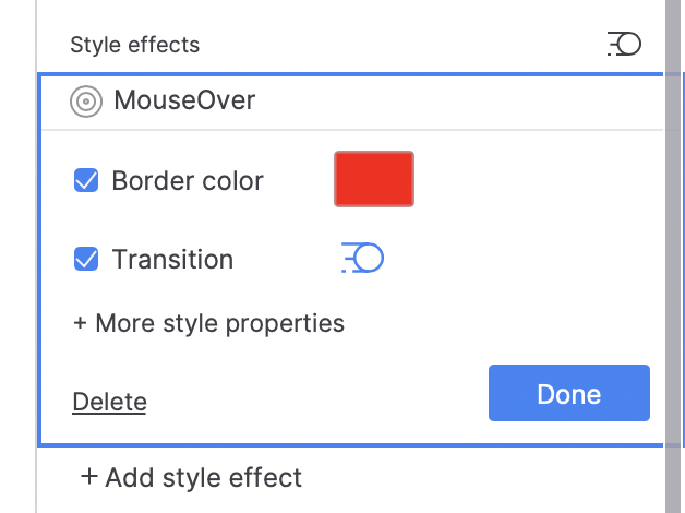

With the release of Axure RP 11, we have added the ability to apply animated transitions between Style Effects. The screenshot below shows an example of how to set this up:
This feature is not available in Axure RP 9. Please write in to support@axure.com if you are interested in upgrading to Axure RP 11 or starting a free 30-day trial to test this feature out. Thank you!
