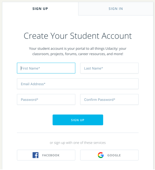

I am wondering how to implement something like this
So the first field has a blue border, then once field is completed, then user moves on to the next field and that one becomes highlighted with the blue border.

@em_91, You can use the Lost Focus event to track when an input field is “completed” --meaning the user has either clicked away from the widget, Pressed keyboard Tab key, or pressed keyboard Enter key (when the text field has a Submit button assigned.) For instance, your First Name field could have:
Lost Focus
Focus lastNameInput
You’ll want to define exactly what “completed” means. Is it simply losing focus or is it “valid input” (e.g., text string of a minimum and/or maximum length; no spaces; no special characters; no numbers; etc.; or for email, does it contain ‘@’ and a “domain” like “.com” or “.org” etc.) --Just depends on the purpose of your prototype and what you need. The best way to do validation is with a “submit button” (right-click on a text field widget and select Assign Submit Button; or click Show All in the INTERACTIONS:TEXT FIELD PROPERTIES area to set this.) Submit buttons can be any widget, can be visible or not. The Click or Tap event of the submit button gets fired when the user presses the keyboard Enter key, which should work well for your form. The submit button for each field can use a sequence of “Else If” Cases to evaluate the text field’s value (the text string) to satisfy whatever requirements you have to “complete” the input, with the final “Else If” case (the “successful input” case) setting the focus to the next field or widget in your form. For example, the First Name field’s submit button could have in its Click or Tap event:

To make things a little more “automatic” and seamless, you could use the text field’s Key Up or Text Changed events (OnKeyUp tends to work better) to test for events that would mean “completed” and call the Fire Event action to trigger your submit button to do validation. in your form example above, if the user presses the spacebar it might naturally be a break between names, signify they are done entering an email address or password, etc. (but for names, consider if a space should be allowed–should a user should be able to enter “Barbara Ann” as a first name or not?) In most cases, can be nice to simply press the keyboard keys, shift+J, o, e, spacebar, shift+S, m, i, t, h --just as they would naturally type their name, and end up with “Joe” in the First Name field and “Smith” in the Last Name field. (You can even use a global variable to track if a user has “re-entered” content in First Name to allow spaces the second time they try.) So, for example, emailInput field could have:
KEY UP
If key pressed equals Space or key pressed equals Right or key pressed equals PageDown
. Fire Event emailSubmitButton fire Click or Tap
LOST FOCUS
To automatically focus the first field in your form, you can use the Page Loaded event or that first field’s Loaded event to "Focus <first widget>"
Finally, the “SIGN UP” button can have a sequence of Cases to test if all the fields are valid before performing its main function, like linking to another page.
FYI, the “natural tab order” of “focusable widgets” is from bottom (in back) to top (in front) in the OUTLINE pane (and by “natural” I mean how it is handled in the browser, which for many designers is opposite of what they would expect–so perhaps “unnatural.” ) By default, text field widgets can get focus. Most other widgets–like buttons–would need an action (even a null action will do) in their Focused event in order to get focus from “keyboard tabbing.” You can drag widgets up and down in the OUTLINE pane or select them on the page and use the Arrange menu, right-click menu, or keyboard shortcuts (e.g., Crl+[ ) to send them backward or frontward. So, in your example form above, the list of widgets as they would appear in OUTLINE would be:
