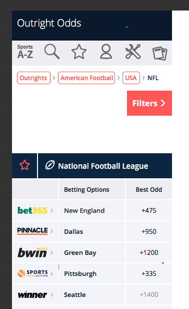

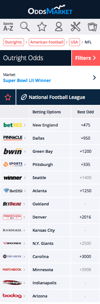

Im getting some issues tho.
I have a screen where the user needs to choose some options to see the content (It’s just a Dynamic panel state change) when the state change occurs, if the plugin is active on that page it throws off some elements. I’ll attach screenshots one with the plugin inactive on that page and one with the plug activated.
Any ideas of what could be happening here?
@robertopib, would you be able to share a source file for this? I know it’s sometimes difficult because it’s proprietary and confidential work, but perhaps you could strip it down just to the issue you’re experiencing?
