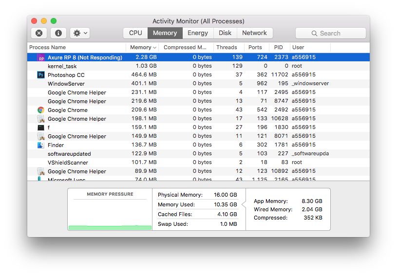

I monitor Axure’s memory usage in Mac OS’s Activity Monitor, and it’s normal to see it go form 900mb to 2gb. Yes, even in Axure 8.
Where is Axure slow? Let me count the ways, and times when it displays the Mac OS spinning beachball, and Activity Monitor says “Axure RP 8 (Not responding)”:
