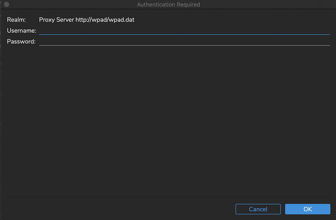

I have no clue why or how to stop it. I do not work over VPN or anything.
I suspect that this could also be the reason why my Axure is often freezing for a few seconds, which is very annoying when heavily working with it.
Thanks for any help!
If you’re on a Mac, go to system settings, search for ‘Proxies’ and disable ‘Auto Proxy Discovery’. With that, I didn’t receive this error message anymore.
If you’re also encountering frequent unresponsiveness, try to delete and reload cloud widget libraries (if you have any).
