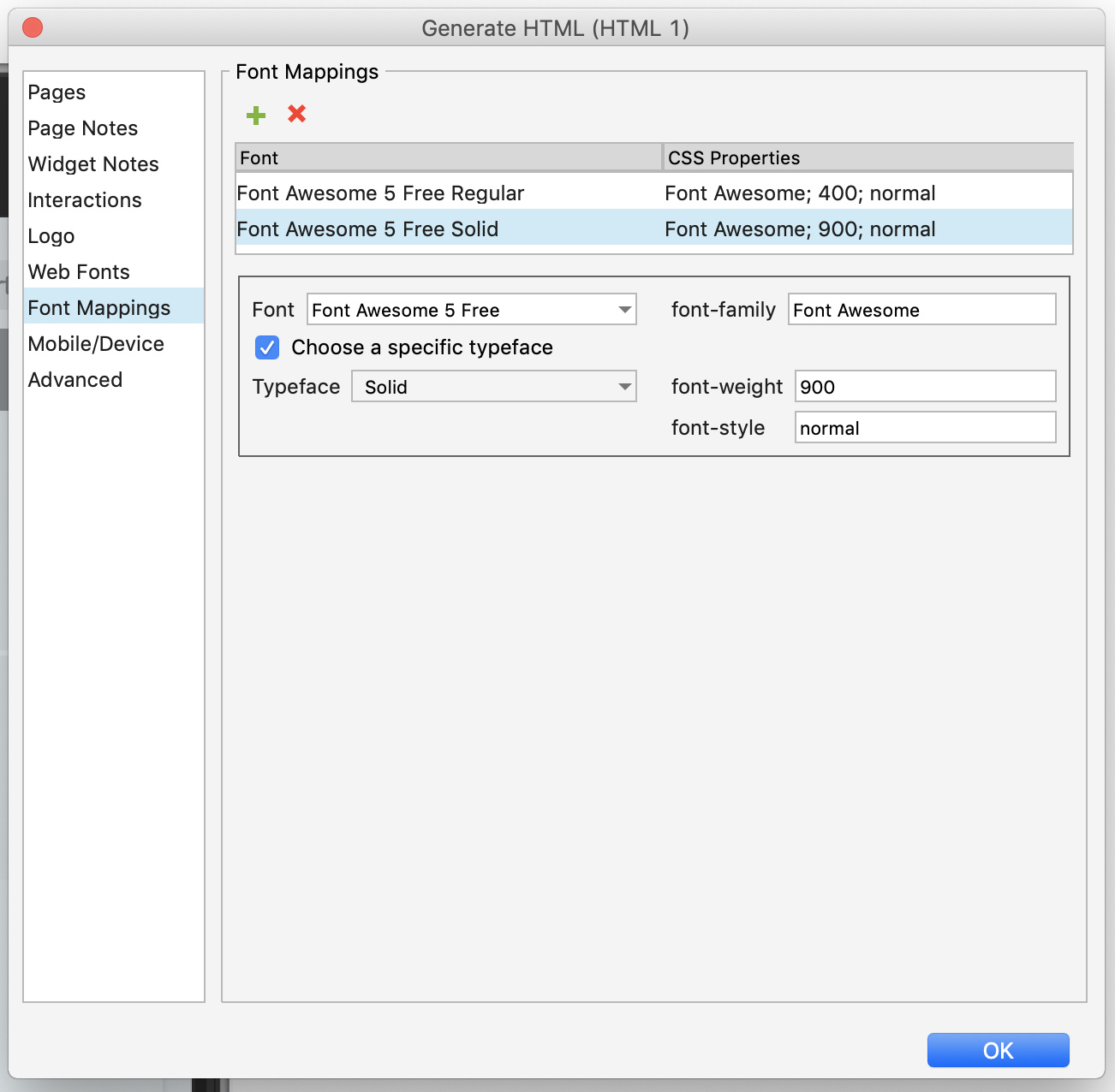

Please help!!! Slowly drowning also tried the font mapping option but they broke them all together and nothing showed up. Below are two images of how my current file is set out, webfont embed and the font mapping, which I have attached here as well.

Thanks for sharing your .rp file and the screenshots! To start, I would like to note that AxureGuru is not affiliated with Axure. I mention this because the main reason why your Font Awesome 5 icons are not rendering properly is because the CSS link from AxureGuru is not working as it should. Rather than using that CSS link, please copy & paste the one directly from the Font Awesome site:
https://use.fontawesome.com/releases/v5.3.1/css/all.css
https://fontawesome.com/how-to-use/on-the-web/setup/getting-started?using=web-fonts-with-css
Once you change the CSS link to the one from the Font Awesome page, your FA5 icons should render in the browser output, in preview or when published to Axure Share. Note that I had to take an extra step to change the icons in your “Environment” dynamic panel from Regular to Solid for them to render properly.
