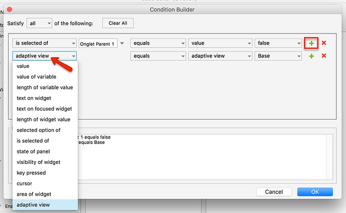

That said, you should be able to add more than one condition to your conditional cases by clicking the green “+” icon in the Condition Builder. For example, in your first file you could have two conditions in the OnClick events of your headers: one that checks if the selected state of the header is true or false, and then another that checks which adaptive view is currently active:
Now both of these conditions will have to be met before the actions in the conditional case are fired. Note that the “Satisfy” dropdown menu is set to “all”, which means that all the conditions listed there must be satisfied in order for the conditional case to be fired. If you need only one of the conditions to be met, you can change that to “any”.
