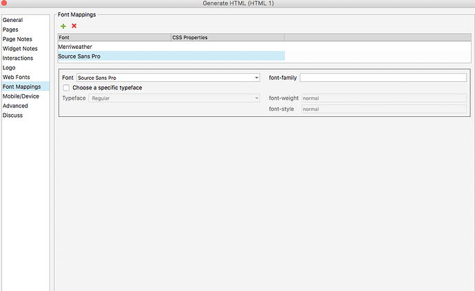

Thank you so much for reply - am giving a screen grab. and Am trying to put in 2 google fonts MERRIWETHER + SOURCE SANS PRO…but still generates fonts incorrectly. Any advice from what you see? Do make t a share file or publlsh to share? Just can’t see t read well on other users screens…Thanks Daryl

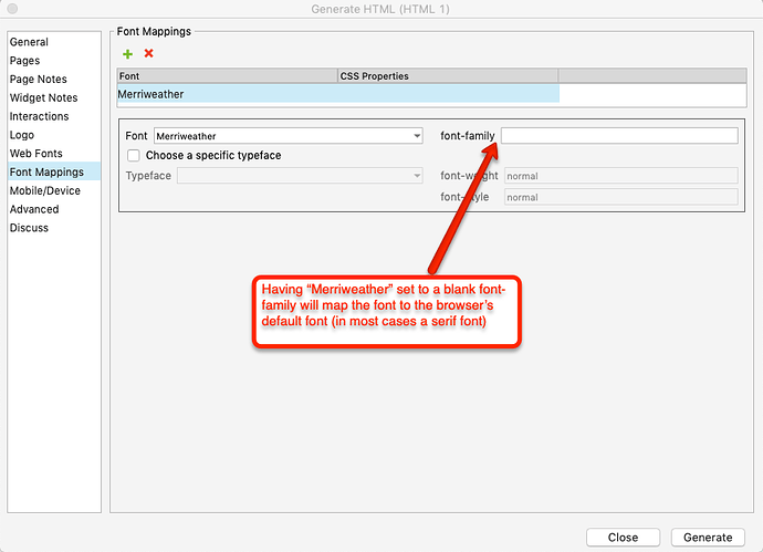

Can you check to see if there are any differences between our files and the HTML generator settings? Also, I recommend checking the “Font Mappings” section. If your file has “Merriweather” or “Source Sans Pro” mapped to an empty font-family, it will map to the browser’s default font. Check out the screenshot below for clarification:

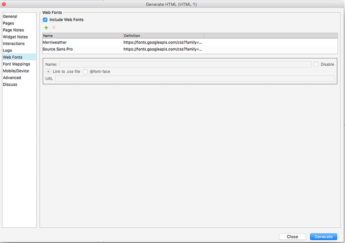

Justin - so appreciate your help with this - it is hard for my designers brain! Now have this mage with the 2 fonts. is this correct? But do I Generate at this point in the lower button? As all I want IS to publish / share the file for viewing on other screens?
Hope you may advise again and thanks! Daryl
…also those fonts read well on screen of another user. So what you have works - just need to see if have done to right from what sent you…Daryl
Hi daryl_lee,
In the screenshot you posted, you’ll want to remove the font mappings you have in place by clicking the red “x” near the top of the dialog for both of the fonts. (You’ll only need to work within the “Web Fonts” section). Once you’ve set your web fonts and removed any blank Font Mappings, you can click “Close” and Axure RP will save your web fonts settings when publishing to Axure Share.

Hi Justin…here is my file. I did the Web Fonts, deleted Font Mappings…just not sure if I click GENERATE at base of screen (or) does this setting stay for every Axure RP file now that I make? Here is file and screen shot (again appreciate this so very much!)…Daryl
Hi daryl_lee,
Thanks for posting that! The .rp file you’ve created is successfully showing the Merriweather and Source Sans Pro fonts in my web browser when publishing to Axure Share.
Now that you’ve successfully set up your web fonts in your HTML generator, you can click “Close” from that dialog. Clicking “Generate” will create a local version of your RP file in the destination you specify under the “General” tab of that dialog.
