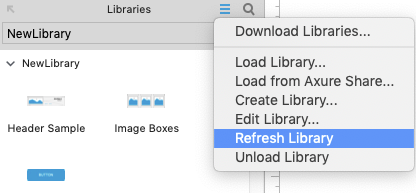

Hmm, if you haven’t done so already, you can try refreshing the library within the Libraries pane to see if the colors refresh on their own:
If all else fails, you could try clearing your libraries cache. This will make it so that the next time Axure RP 8 is relaunched, it reloads all of your added libraries, and it should help ensure that the most recent thumbnails for the widgets are displayed. The library cache location varies between operating systems, but you should be able to find them at one of the two following paths:
On Windows:
C:\Users\%USERNAME%\AppData\Local\Axure\Axure-8-0\cache3
“AppData” is a hidden folder, so you can copy and paste the path into your File Explorer field or make sure that your File Explorer settings are set to show hidden folders when navigating to this path.
On Mac:
~/Library/Application Support/Axure/Axure-8-0/cache3
You can access the Library folder and this path by opening your Finder application and selecting “Go > Go to Folder”, and then pasting this path into the given field.
From there, you can delete the cached files from this folder, and then relaunch the application to check the libraries’ behaviors.
I hope that helps!
