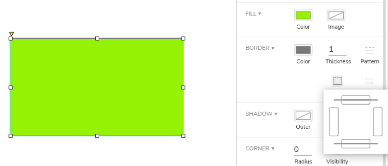

S1: Add a box, and set the border visibility.

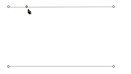

S2: Move the cursor to the edge of the widget and double click the mouce. It will enter the point edit mode.
S3: Add a point, the background color will disappear and can’t be set.

After following your steps, I was able to reproduce the same issue, and I reached out to our teams as to whether this was a bug or expected behavior. While I agree it’s unexpected where the fill for the widget goes missing, this is the expected behavior for now. When converting a shape with non-adjacent borders to a custom shape - which is what happens when you enter point edit mode - each border line becomes its own shape, but they’re still represented as one shape because they’re united. You can break the shapes apart by right-clicking on the shape and selecting “Transform Shape > Break Apart”.
