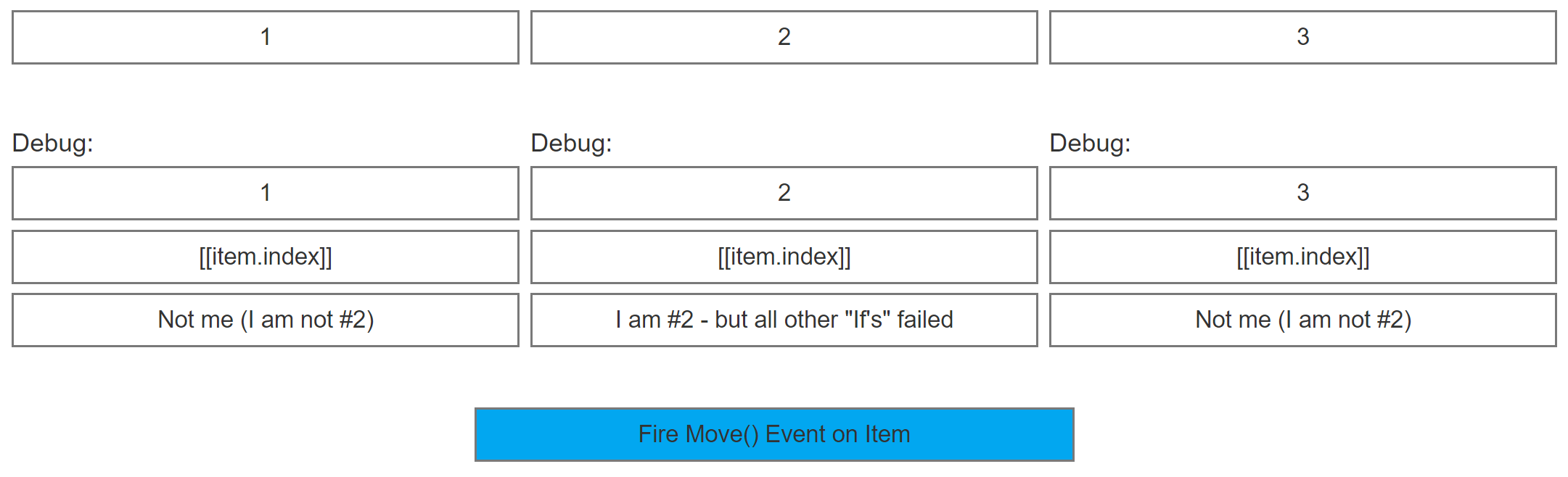

As you can see - the global variable LITERALLY contains the text “[[item.index]]” which is remarkable because assigning the exact same expression to the text box results in “2”.
If Set Text can access [[item.index]] properly, how come nothing else in this listener can?
I cannot tell you why Item.index is not available when setting the variable (it is also NaN while setting a label), but in your case you could set your variable to Item.column0. This works. I hope this helps.
Hi, JMW. I struggled with something like this recently, too. Check the attached. The only change I made was the addition of the button that actually moves the item instead of firing the Moved event.
An explanation I got from support is that the interaction outside of the repeater doesn’t have access to the repeater database, which is required to get at the index value. By actually moving the widget you’re getting an event to fire inside the repeater, and it works. This difference in behavior suggests that the “fire event” action doesn’t do literally that–maybe it just performs the actions attached to that event, correcting for “this” and “target” references–but whatever the difference it doesn’t seem to matter except in a few situations like this.

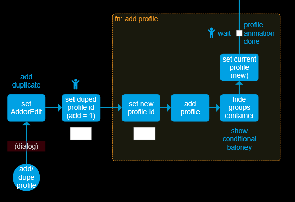

It occurred to me that maybe you’ll find this relevant, or at least entertaining. Here’s a flow chart from a recent project in which I had three repeaters that needed to be in sync while allowing the user to add/delete/duplicate members of any of them. (The data in the three repeaters represented three levels of hierarchy, so a duplication of an item at the top level meant copying the relevant rows in the other two, etc. It got hairy.)
Here’s a detail:
The blue boxes just outline what’s going on, but the orange dotted outlines are the widgets that contain functions. So, the OnClick event of the orange box in creates a new profile ID (and puts it in that text box), adds the new profile item, etc. As you suggest, this lets you actually click on those components to test a part of the logic in isolation.

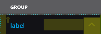

I incorporated as much of the logic as I could into this chart, but of course sometimes you need to trigger something to happen inside the repeater item. The little person icon next to the blue shape indicates that–all three repeaters have one of these little dudes hidden in there:
This little “elf” inside the repeater is where all those are kept, on various events.
