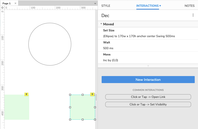

Hi Candourist!
Thanks for sending this along! It looks like this issue may be due to the way that the two hotspots fire their Move by actions without any breaks between the two events. Although the resizing animation will take 500 ms to finish displaying, the “move” action fires immediately after the resize starts. Since there are no “Wait” actions between the resize and the move actions, the two hotspots are firing immediately after one another. I was able to reproduce this issue in another file without any animations as well. To workaround the issue, I added a “wait” event to the second widget’s event, between a “Set Text” and “Move by” action. This made it so that the page dimensions displayed correctly, and all of the interactions did not fire so rapidly.
wait-workaround-sample.rp (58.1 KB)
I’ve attached my sample file for your review above. It looks like making a similar change to the “Dec” hotspot in your project should allow for the page dimensions to display correctly as well:
This behavior looks to be unexpected, so I’ll be filing a bug report on this issue on your behalf. I hope this all helps!
