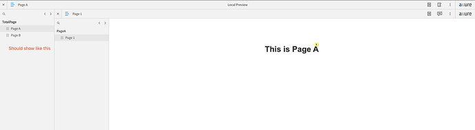

Hi Goko!
It looks like this behavior is occurring because all of the external links you’re navigating to include the player’s sidebar. By default, a link like 123456.axshare.com will direct to page where the side bar is included. If you have one project link load in the frame for another project, you can wind up with multiple side bars open. Sidebar settings can changed by changing the HTML generator settings for the Axure RP 8 project, as described in the article here.
Alternatively, you could use the Page Loaded event’s links to direct to a versions of the projects where the sidebar is fully closed. Adding “/#c=2” to the end of a link, like 123456.axshare.com/#c=2 makes it so that when the link opens, the sidebar is fully closed. One thing to note is that notes are contained in the player’s sidebar, so notes will not display if the sidebar is fully closed. As an alternative, you could add page notes to the main, Axure RP 9 version of the project. I hope this helps!

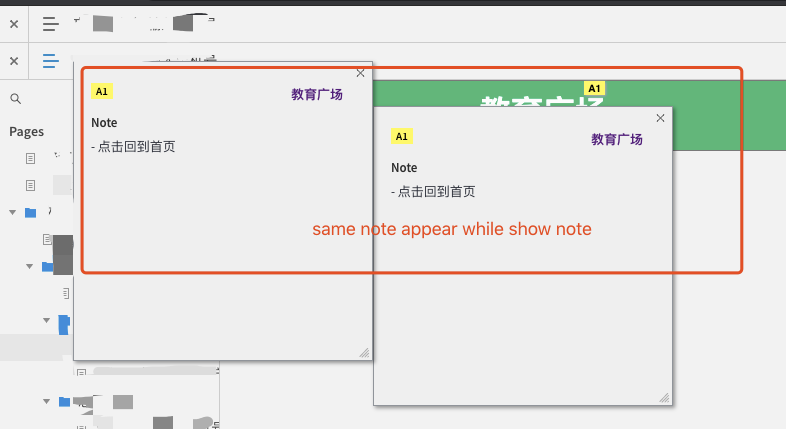

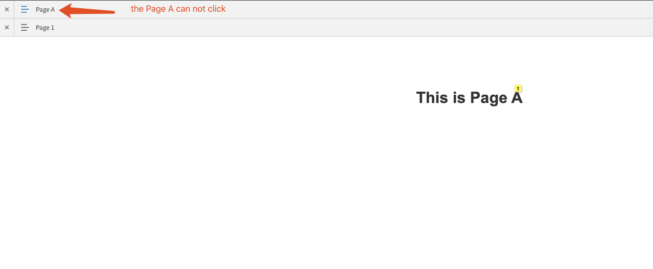

Hi Chelsea,
Thanks for your reply, And yes, i want to have one project link load in the frame for another project with both side bar enable. While i preview the nested project ,it looks fine, but when i generate html and upload it to my own svn server, the same note appears when i click it.
Editting the window size 【Scale to Width】、【Scale to Fit it】is also unavailable.
Hi Goko!
Thanks so much for the clarification. It’s possible that this behavior is occurring because of a bug that was fixed in a recent release candidate, where the project’s player would open multiple times. If you haven’t done so already, you can try using the release candidate by navigating to “Help > Check for Updates” and then check the “Include beta channel builds” checkbox. After updating, you can try regenerating your project to check on the behavior.
If any issues persist, please email us at support@axure.com so that we can take a closer look into these issues. Thank you!
