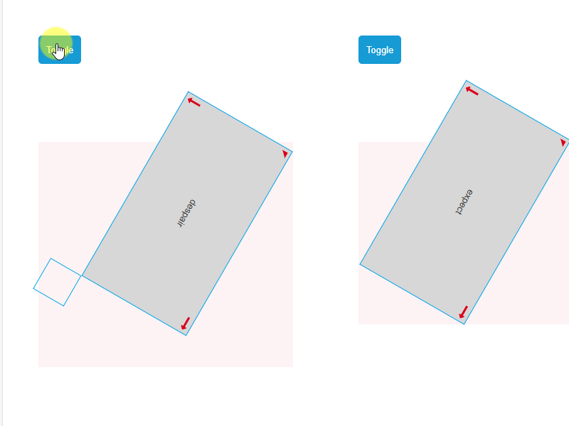

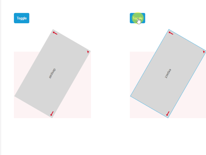

[BUG REPORT]The dynamically resized panel with 'Fit Content' does not meet the expected expansion dimensions after rotation
This is the appearance I expect.
This is the demonstration of the implementation.

The “Fit to Content” feature of the dynamic panel attempts to fit widgets to the top left corner of the container, regardless of rotation.
If you still need to have “Fit to Content” of the dynamic panel enabled but do not want toggling this visibility to affect the position, then you can group and rotate these widgets instead. I have made these edits to the attached file The dynamically resized panel with ‘Fit Content’ does not meet the expected expansion dimensions after rotation. - Axure Edit.rp (65.3 KB). Otherwise, you can turn off this setting when using this widget setup.
In the meantime, I’ll inform our product team about this behavior to review.
The dynamically resized panel with ‘Fit Content’ does not meet the expected expansion dimensions after rotation 061325…rp (56.7 KB)
I think the “Fit to Content” function should always align to the top-left corner of the dynamic panel, regardless of its rotation .@ BenHoang_Axure
