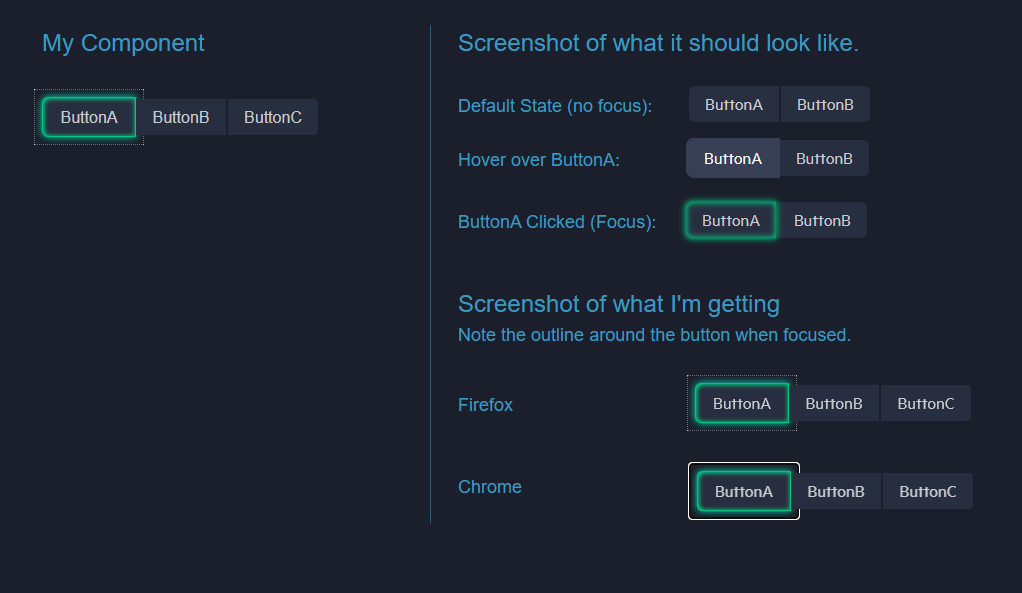

Have a look at the attached PR9 file. i have a button group in which one button can have focus at a time. On ‘click outside’ focus is lost. It would seem that I have a very simple solution to replicating what I need, however Axure is giving my buttons a white outline.
Try using Selection instead of Focus. If you programmatically set focus on a widget, some browsers will still show their own focus indicator, to ensure accessibility.
To do this, style Selected just as you have for Focused, and remove the Focused style for these buttons. Assign a Selection Group to all 3 buttons (click “Show More” in the Interaction Styles section.) Then change your Set Focus actions to Set Selected.

Here’s another approach: in the updated file below I defined a Focused interaction style for the buttons to match your Selected style (and created a named Widget Style for this, just to make it easier to apply to multiple widgets.) For me, on Windows 10, it overrides the browser’s focus style in Chrome, Firefox and Edge. See “My Component 3 (focus only)” in which each button just has “Focus This” in the Click or Tap event. I think this works the way you intend.
I also made a “My Component 4 (select only)” to show a workaround for that method. The group has a Mouse Exit event that unselects all its widgets. Not the same as doing this with any other click, but similar. Other than this, you could set a Page Clicked event that does same thing, or include other clickable widgets in the same selection group.
