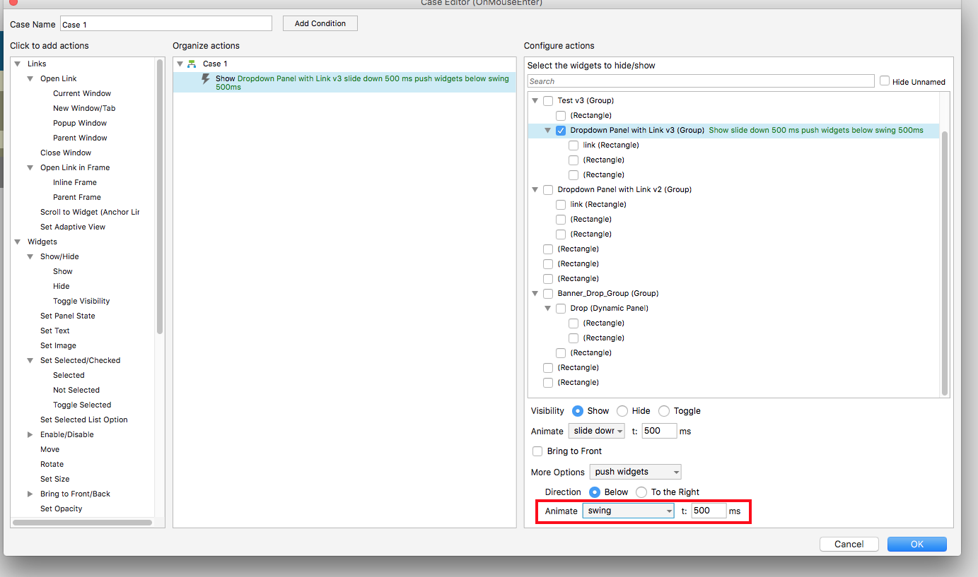

One idea to build off MurrayEaton’s setup is to group the banner and its dropdown image, and then create the OnMouseOut case on the group instead of on the image. To access the OnMouseOut event for a group, click the “More Events” dropdown in the Inspector: https://www.screencast.com/t/kNrB9RZJdT.

You can smooth out the animation by adding an animation effect—the dynamic panel version has a “swing 500ms” on it. Once you add it to your non-dynamic panel version, it will be smooth too.
Ah, I was just building off of MurrayEaton’s sample file which already included the dynamic panel setup. As skb mentions, adding a swing animation for the push and pull will smooth things over. In short, your current approach is entirely fine, but read on to learn more about possible issues unique to groups versus DPs.
