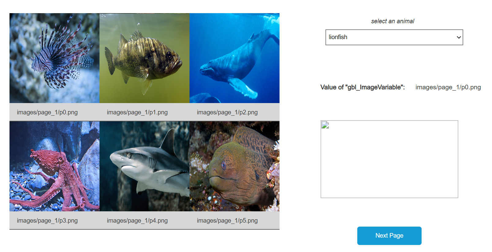

I’d never tried to assign an image to a variable before. As you said, it seems to can’t assign an image to a variable, but it looks like you can assign a path to an image: Image_To_Variable.rp (4.2 MB)
This method is pretty brittle. it uses [[Item.Index]] as part of the path so if you sort or filter the repeater, the paths will break. It’s possible to use Javascript injection as a stronger method to get the path but was trying to stay in native Axure.

I created the repeater, added the images to it, and launched the preview. I used the browser tool to inspect the image elements to find their “src” attribute. In my case it looked like this:
img id=“u2-3_img” class=“img u2_img” src=“images/page_1/p0.png” style=“border-radius: 0px; width: 196px; height: 196px;”
The “p0.png” incremented for each image so that’s why I used [[Item.Index]] as part of generating the paths. (It’s also the reason why sorting or filtering the list will cause things to break; the index has changed but the file name for the image hasn’t.)
