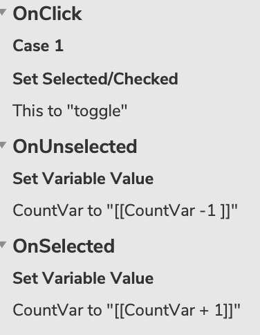

I didn’t quite understand the things you want to do with transferring values. I don’t understand the relationship between the cards on the right versus the cards (are these cards?) on the left, but for updating a count global variable, you just need to do this:
…where CountVar is a global variable defaulted to 0.
I looks like you tried to do this with a variable called NumberSelectedFlashcards, but you didn’t have that global variable defined in the Global Variables list, so Axure didn’t know what it was.
