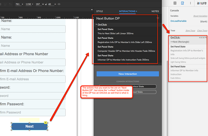

Hi! It looks like there’s a conflict between the OnClick interactions on the “Next Button DP” and the “++Next” button contained within that dynamic panel. Your dynamic panel has the four Set Panel State interactions that you want to fire, but since the “++Next” button inside of it also has an OnClick (and is only setting the panel state of two of the panels) that is what you wind up seeing fire instead:
To resolve that, you’ll want to put the four desired Set Panel State interactions on either the dynamic panel or the button contained within it and clear the other widget’s OnClick interaction. Hopefully that helps!
