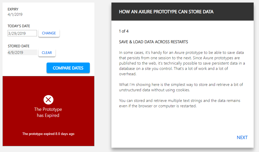

Thanks Bill, this is exactly what the doctor ordered! Wow! Thank you! It’s true that I have spent over an hour going through your demo and have learnt a lot. I still don’t understand why you check for the time component of the date… but I’ll work it out.

Hi nkrisc, of course everything is hackable… however this is an EXCELLENT solution to store persistent data locally from within Axure. And more importantly it perfectly solved the problem I posed when most would consider it to be impossible.
Hi nkrisc. Interesting point. However, I think this is pretty good for simple persistent data storage or this specific use case: having a client try a prototype offline on their own PC and then expire at some point.

You are most welcome The reason I check for the time component of the date (# of seconds since the epoch date), is that it allows a simple math comparison of whether one date is > than another.

To keep my focus on design and not coding, I find it’s easier to fake a database with a hidden repeater within the Axure file, or by having a whole bunch of variables that are stored using webstorage as shown in this sample. You can store lots of variables (up to 5Mb) in webstorage, but of course, that is local to one user’s machine, not shared between users like a real external DB.
