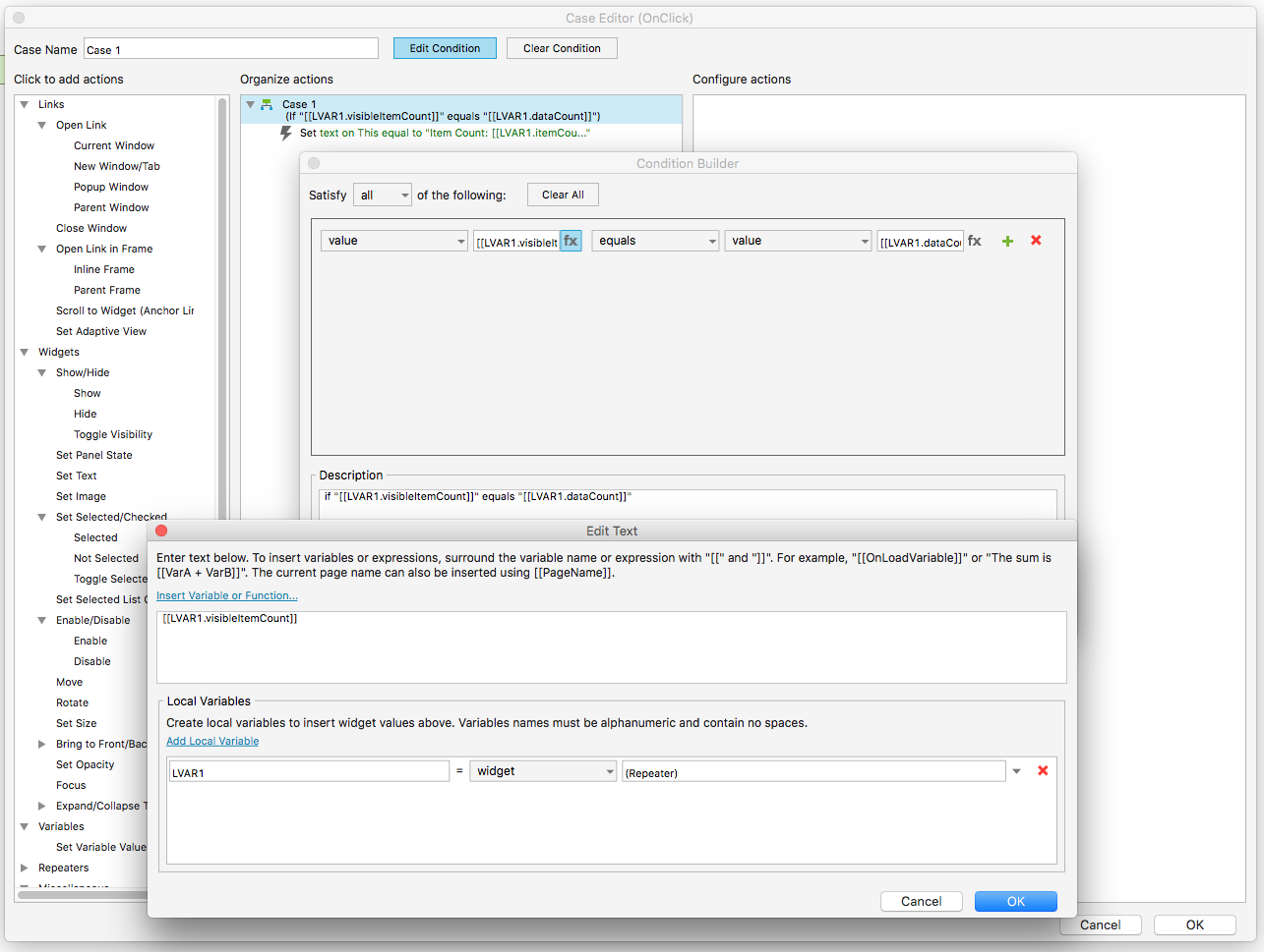

If the repeater doesn’t have multiple pages you can use a condition:
[[LVAR1.visibleItemCount]] equals [[LVAR1.dataCount]]
This means no filter is set.
