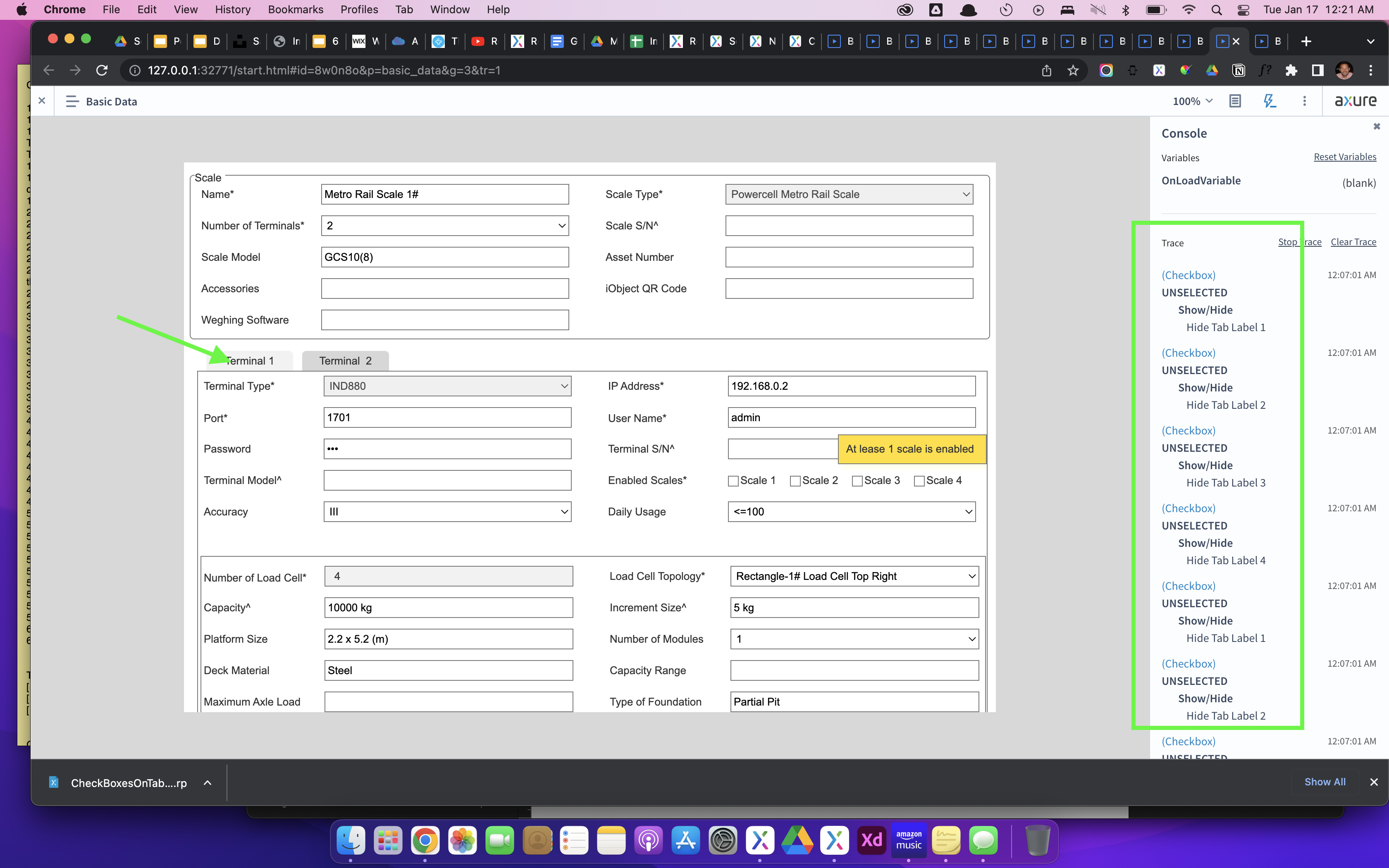

Here’s what I did: After a bit of testing, I noticed that when I ran your prototype in the browser with the console open, if my first click was on the “Terminal 1” tab, all the checkboxes become unchecked.

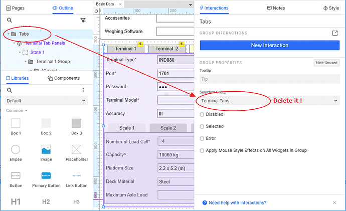

So to try to understand what was happening, I regrouped and renamed some of your components, specifically the item in the top most panel, and the items in “Terminal 1” State of the Terminal dynamic panel. After I did that, I noticed a shape (“panel 1 contents”, I believe) blocking the checkboxes, and deleted that shape. After that, when I tested the prototype, it worked as I had hoped it would.
I included screenshots, before and after, showing console traces of what happened when I clicked “Terminal 1”.

It really works, many thanks.
Great, you find the key, thanks a lot~ Have a good day!
Thanks Jorkin for pinpointing the issue! This was my first time working with selection tabs :}
