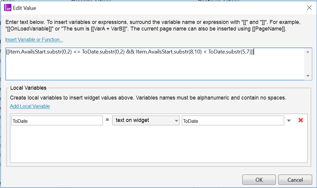

Okay I’ve narrowed it down to the second part of the filter - the first part - [[RPMonth <= SliderMonth && RPYear = SliderYear]] fine by itself, but the second part - [[RPMonth > SliderMonth && RPYear < SliderYear]] - does NOT work by itself.

Oh, should have clarified, sorry. The first half of my double filter worked fine; it was only the second half that was giving me problems, so that’s the filter I included in the rp I uploaded. It’s on the submit button. It’s not working by itself. So my goal is to get that part working and then try joining it back to the first half with the ||
Ok. Not on my computer but analyzing the expression you might be having trouble with the second half. You’re using substr which takes the start index and the number of following characters. So you’re comparing the 10 characters following the character in the 9th position (remember 0 indexed) of one value to the 7 characters following the 6th character of the other value.
Perhaps you meant to use substring() which takes the start and end index instead. Or instead change the second argument to 2 if you only want the 2 characters following that index.
Hmmm, interesting, as substr has been working correctly for me elsewhere - I tested it by displaying the substr values in a box, just to make sure because I’m always unsure of exactly which numbers to use. I will try substring and see if it makes a difference. I’ll try anything at this point!

I replaced substr with substring and I’m getting the exact same results. Tried with slice and got the same results. ARGHFilter Problem 3 ways.rp (112.1 KB)
