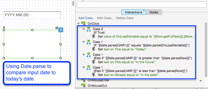

Do you still need help with this? I’m not sure I’ve understood your question completely. What is the format of the input date?
You could, for example, instruct the user to input a date in the “YYYY.MM.DD” format and then use:
Date.Parse(inputdate) to compare the dates.
Like in this screenshot:
And the file is attached.
But, I’m still not convinced I’ve understood your original query. If I’ve missed the mark and you still need help, I’m happy to take a look!
DateCompare.rp (53.9 KB)
