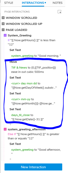

I’ve added conditional logic to the Page Loaded interaction on my form and find that now all other interactions not belonging to that logic are assumed under it. I’ve tried to move them out of the conditional grouping but to no avail. Any suggestions?!
In other words, I want the conditional logic to set the greeting on the screen to ‘Good morning’ or ‘Good afternoon.’ All other interactions are the same regardless of morning or afternoon. Must they also be in a conditional group? Is there simply an Else?

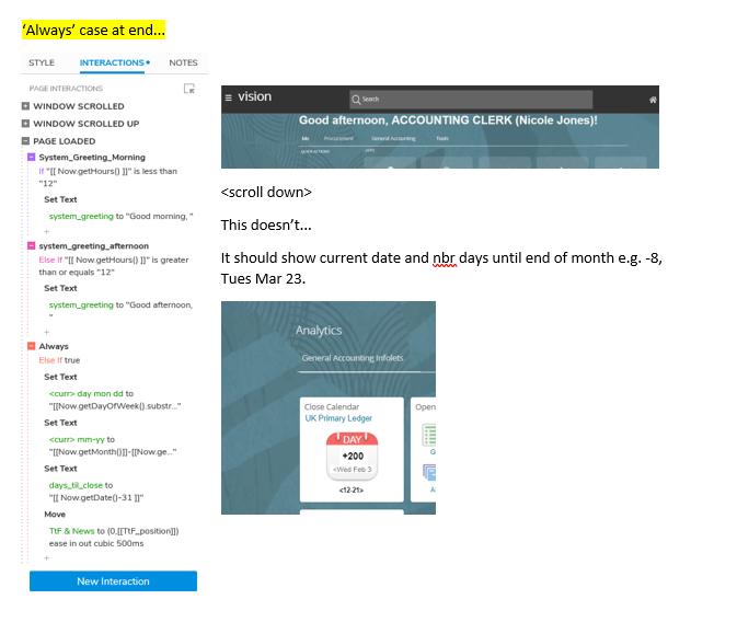

I want the page to greet the user depending on morning or afternoon. I’ve created cases based on [[ Now.getHours() ]] i.e. <12=‘Good morning’, >=12=‘Good afternoon’. The other Move and Set Text interactions have nothing to do with the greeting. I want them to be outside of the conditional cases.

I still can’t access your .rp file, only your published HTML. But, your screenshot helps. In this situation you’d have at least three conditions to handle, thus three conditional cases:
Case 1: System Greeting Morning
If [[Now.getHours()]] is less than “12”
Set Text system_greeting …
Case 2: System Greeting Afternoon
Else if [[Now.getHours()]] is greater than or equals “12”
Case 3: Always
If True
Move …
Set Text …
Set Text …
etc. …
The key thing is the “Always” case needs to be an “IF” and not an “ELSE IF” and have no conditional logic (thus it results in “If true” …and logically, “true is always true”)
You could make it the first case, which automatically sets it as an “IF” case. This works fine and usually makes more sense. Just ensure the second case is and “IF” and not “ELSE IF” because the latter equates to “ELSE IF true is not true” which is impossible, so it would never get triggered.
Realize that all “ELSE IF” cases are ordered and get triggered in the order you set them, but all “IF” cases are unordered so you have no control over when they get called by the browser. So, in my example above, the “Case 3: Always” would not necessarily happen after Case 1 and Case 2. Usually this doesn’t matter, but let’s say you needed to do something different in Case 3 based on the results of Case 1. You’d need to rethink the logic, possibly duplicating actions in Case 1 and Case 3.

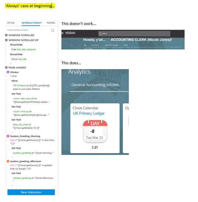

Me again. I tried it but find I cannot create a second IF within the same Interaction. It’s always Else IF if not the first one. So either the greeting works and not the Always actions, or the Always works and not the greeting.

Hi, MollyB. If you right-click on the IF or ELSE in the interaction pane, the contextual menu has an option: “Toggle IF/ELSE IF” that should do what you hope to do.
