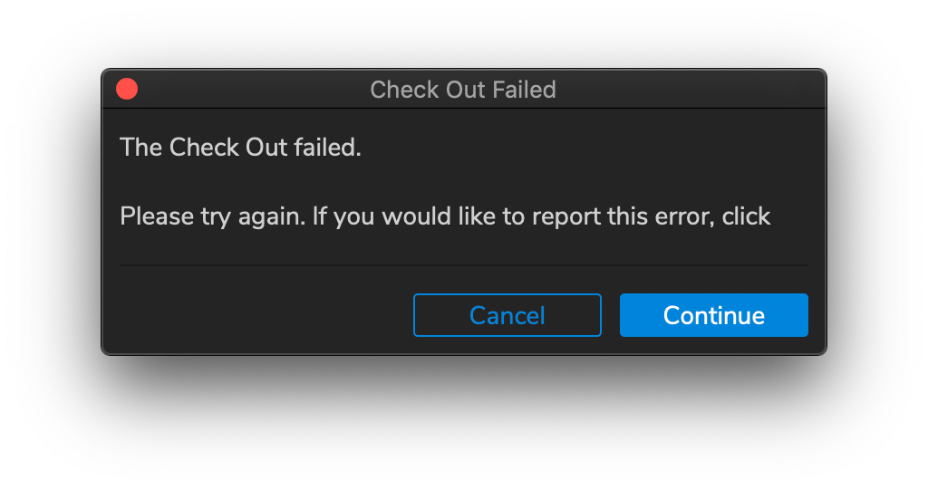

Since the last update I was getting this error quite constantly and I had to restart Axure to make it work everytime. Now not even restarting is doing the trick. I can’t check out any pages and, again, Axure is getting in the way of my work.
Anyone having this issue? Can anyone from the Axure team help me with this?
For those following along, guzforster submitted the errors to our help desk and it seems that the errors are only happening when using their VPN and works fine without it. If anyone else is running into similar issues then please verify whether not using a VPN as a test works, and if so feel free to email more details about your VPN setup to support@axure.com. Thank you!
