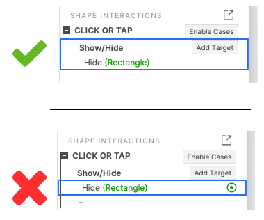

Thanks for writing in. In RP 10, you can copy an action and paste it to another event. In the example below, you can select the action by clicking next to the “Show/Hide” text. This will select the entire Show/Hide action, and allow you to paste elsewhere in the Interactions pane, including to other Events.
What you may have noticed is that copying and pasting only a target is not supported. In the example below, the target “Hide (Rectangle)” cannot be copied and pasted by itself. I can see how this can be frustrating so I’ve logged a feature request to have the team take a look at enabling copying and pasting targets.
