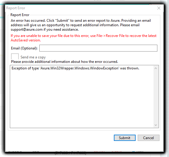

I’m using Axure 9 and noticed an usual bug: when I try to rename certain folders, Axure crashes - but not always.
Steps to reproduce:
*Double click on a folder in the Outline panel
*Change the name of that folder
*Press enter
*Axure throws an exception and the “Report Error” popup appears - endless times. A few seconds later Axure crashes
What I managed to work out so far:
*Axure only crashes if Enter is pressed to rename the folder; if I click outside to dismiss the edit mode Axure doesn’t crash
*This seems to happen when a file reaches a certain complexity; if there’s not much in that file (maybe in the page?), I can rename a folder by pressing enter. As the file (page?) increases in complexity the crashes start to happen
*The crash happens with unrelated files (two files belonging to two different projects)
Please let me know if there’s any other information I can provide to help fix this issue.
